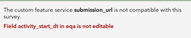

I have a feature service published from ArcGIS Pro with some attributes set as read only to prevent editing.  These fields have editable:false in the feature service as expected.
activity_start_dt ( type: esriFieldTypeDate, alias: Activity Date, editable: false, nullable: true, length: 8, defaultValue: null, modelName: activity_start_dt )
When publishing a Survey123 with the same questions also as read only (this survey is for Inbox use), Connect returns the error that the read only attributes are read only, yet this is for read only questions.
Is this a known issue or is there something else I can do in my Survey XLSForm to enable publication?

Hi. This is an oversight in the Survey123 Connect validation. I suggest you submit an official enhancement request via Esri Technical Suppport.  In the meantime, you could do the following:
  • Make your fields editable (temporarily)
  • Publish the survey while the fields are read-write
  • Switch the fields to read-only once the survey is published
