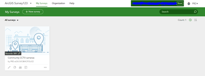

We have S123 connected to our Portal. I created a form in S123 web designer. The form is shared across the organisation and it’s working ok.
The problem is when I tried to access the designer, it doesn’t allow me to access the form. Error below. The user you see in the snapshots below is the owner of the survey.
I need a hand with this. This survey is in production and I have all Victoria Police starting to contribute to it.

WalterSimonazzi_VicPol

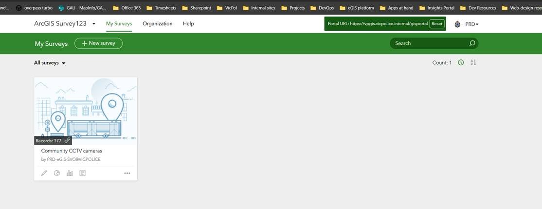

I created he survey via Web Designer using the user PRD*** (the user displayed in the first snapshot). This user is the owner of the form and the feature service.
I shared the form internally and they are currently using it. I'm receiving data and can see it coming in the feature service.
What I would like to do now is to use the "Analyse" and "Data" sections to analyse the data and visualise what I'm receiving from my users (I don't want to modify anything from the form, it's already in production).
Just right after I created the form I was able to access to Data and Analyse and see the data I was receiving, then it stops working.
Between when it was working and when it stops working I bulk upload some data to the feature service using ArcGIS Pro. After the bulk update the feature service was and is working all ok, no issues with it but the form is now inaccessible.

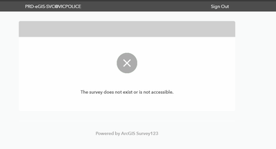

When I log in using the PRD*** user and click on "Data or "Analyse" buttons (well, on any of the options under the form), I get the error below:
The form and the feature service are owned by the user I mentioned above.

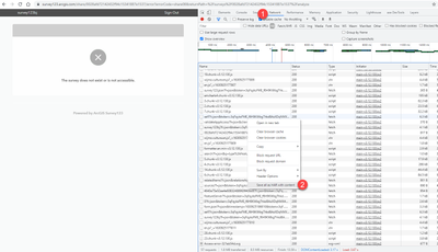

If this is not the case, could you please send the network recording HAR file to my email jxu@esri.com so that we can identify the cause of it?
1. Please open your developer tools by pressing F12, go to network tab
2. While the developer tool is opened, visit the analyze page and data that you encountered the error
3. Save the network request as HAR file
