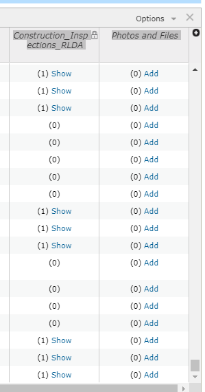

I noticed if I submit data from the web version, submission successfully goes through but it creates orphaned data.  Destination key field gets filled with random global ID and not with the parent's.
If I submit from the Windows version, it creates records with correct relationship.   Another thing I noticed is GLOBALID's field's alias is GlobalID - could this be relevant?  Below is the screenshot of the child table.  The ones with no parent to show was submitted from the web form.

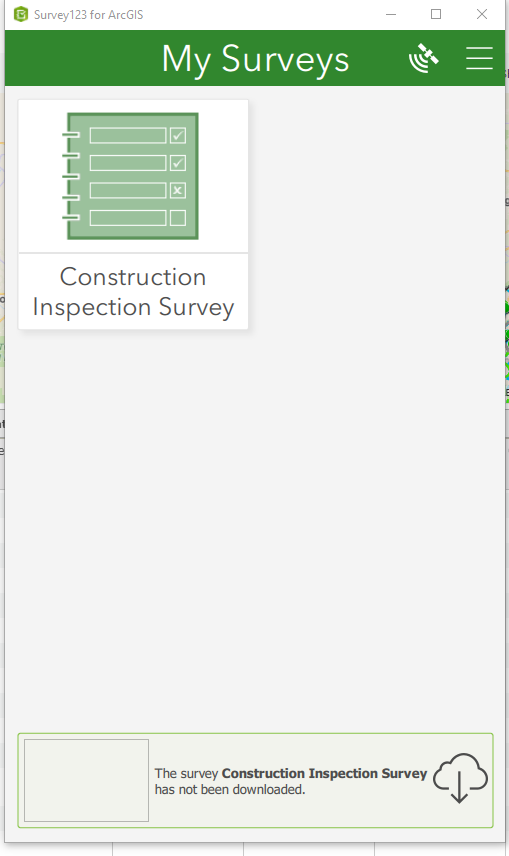

I was going to opt to use the Windows version until I figure this out.  This is the URL I use to pre-populate the form
arcgis-survey123://?itemID=f20c94470121473ebd9fd05d919eddcd?portalUrl=https://vdotgisuportal.vdot.virginia.gov/portal&field:ASSETGUID=%7B92E7BA30-1492-434C-BEF6-5596B5A48518%7D&field:PROJECT_NAME=&field:PROJECT_NUM=501-18130-028&field:UPC=107992&field:VAR10_NUM=VAR10J722
But this link never loads the form.  I already have downloaded the form, but it is constantly showing a message that it hasn't.  This workflow was working fine on ArcGIS Online.  Is my URL faulty?
AhjungKim4
Yes, the URL is faulty.  I removed the portal bit and it opens the form
