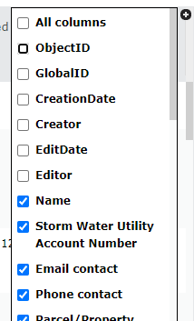

I'm building a survey that's meant to be public-facing (the FL and form are shared with everyone) and I'd like to have some fields available to internal staff that are not available on the public survey
Is it possible to have fields available on the Data page in S123 but not on the Survey itself?
I've set up editing applications and I can add fields to the FL that aren't on the survey, but I'd like to be able to print and export records from each survey (something I haven't been able to set up in the applications, but can be done from the Data page)
wilcow
I was able to do this by deleting the fields from the Survey in Design (this doesn't delete the fields from the FL), and then adding those fields in the Data page using the plus sign on the far right of the attribute table
