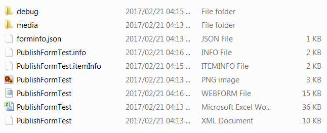

The survey "staging" folder has this in it, is there some way to publish this manually?
