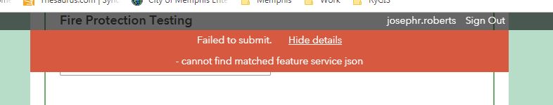

Hi,
I am trying to submit a survey for a Fire Inspection Survey that I built.  The survey will be utilized to track the notes on a particular facility (feature class).  However, I have been unsuccessful at submitting the survey due the prompt above
The survey is suppose to push the entries of the survey to a table in my SQL geodatabase.  The table is related to a feature class via GUID; with the feature class having a primary Global ID and my survey table having a GUID field with a one to many relationship (I have attached the parameters of the relationship)
The services have been published on an portal ArcGIS Server.
If you have any insight or questions, please comment at your soonest convenience.

I am seeing this same error with a similar setup, survey pushing to a related table with a GUID relationship onto a portal feature service. One note is I have success submitting my survey using the windows and apple apps, only seeing this error when in the browser survey.

Your situation is very similar to mine.  My survey functions on the desktop application but will not work on the web.

I have a very similar issue, while publishing a table with a related feature class as a hosted feature service.
It appears to work with the Survey123 Field App but I have the same error with the web form, which is what I want for this Survey.

I found a workaround by turning the related table into a feature class (in this case I have now a polygon FC related to a point FC). Even with no polygon geometry written by Survey123, it works fine. I think that the bug only appears with related tables without geometry.
