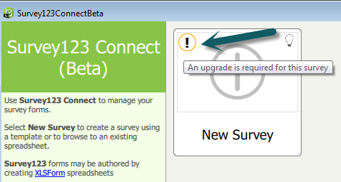

I am getting this error message in my Survey123 Connect program yet I am running 1.4.30. I am however running a free 60 day trial of it and wondering if that is the issue? Any help would be great.
I can still create and use reports but nothing actually goes to my online Survey123 for ArcGIS, where I can look at the data. Gives me a message that no records have been updated.
Hi Travis. You can ignore the upgrade button message. It is a bug which will be addressed in our next update (planned to be made available next week).
