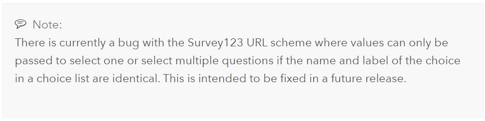

Based on this document about integrating Survey123 with other apps, there is currently a bug in Survey123 where the labels and name fields of choices in choice lists need to be identical in order to pass filled values into another app, such as Collector e.g. arcgis-survey123://?itemID=36ff9e8c13e042a58cfce4ad87f55d19&field:surname={name}.

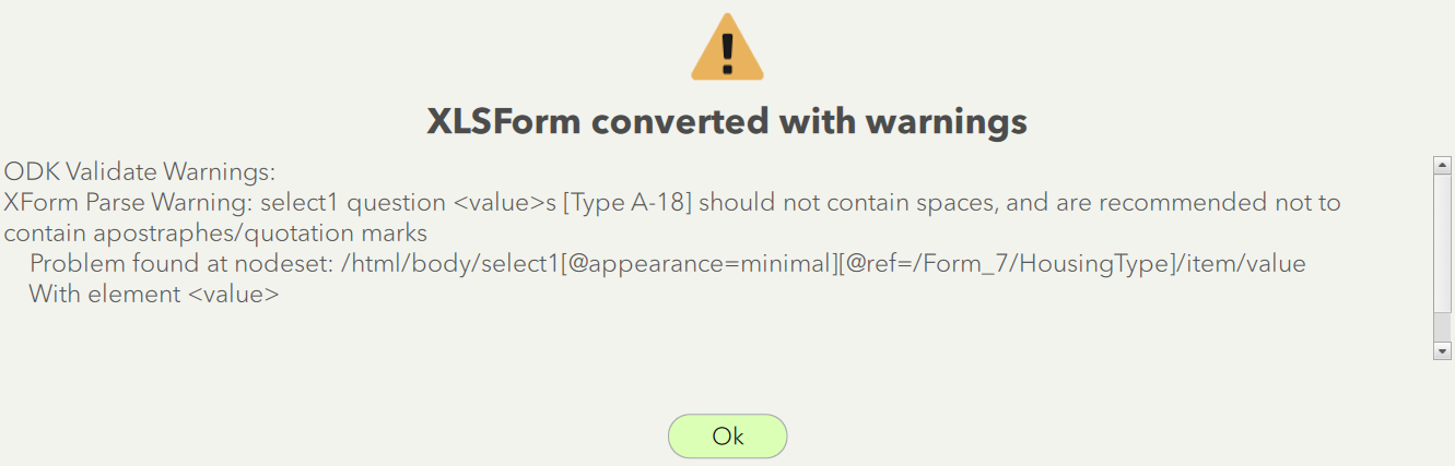

Therefore, I tried to design a form where the name and label are identical with spaces between words for readability and a user-friendly experience for end users. However, I received a warning where the form is converted with warning that choice names should not contain spaces. Since this is a "should not" warning and not a "must not" error. I would like to know will there be performance issues if I publish a Survey123 form whose choices have spaces?

According to the XLSForm specification, spaces are not allowed in a choice; this is due to the use of a space as a delimiter within XLSForm.  As you note, you will generate a warning on publishing of the form.  This issue will be more fully addressed by the next version of Collector, which will support Arcade for pop-ups.
