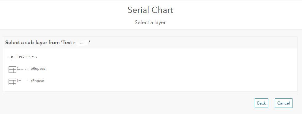

JulietK
Hi Phil, thank you for your response.
Unfortunately I am unable to share the file but I've resolved the issue by altering the survey configuration/table schema itself.
Just out of curiosity, I thought all repeats were output into their own table/sublayer (separate from data from fields outside the repeat) regardless of the general configuration?
e.g. this is a page I encounter when in dashboard and I create a new panel > select layer (output from survey123 form containing 2 repeats). It shows the parent layer at the top, and two table layers which are each created from the two repeats in the survey.
If there actually is a way to retain the two separate repeats in the survey, but have an output of 1 layer containing the contents of all the 3 layers in the example above, it would be very helpful to know 🙂

by Anonymous User
Not applicable
Hi Juliet,
What you are seeing in the Dashboard is correct, there is no way to display all the fields/questions from the related tables/layers in the same table/view of the parent layer.
Regards,
Phil.
