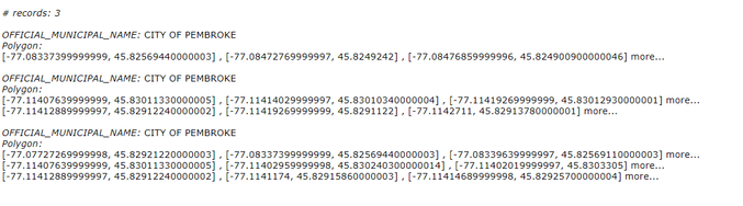

Based on your examples I think it is because Peterborough returns just 1 record and Pembroke is returning 3.  This probably means there is a list returned if 3 and not a list for the one maybe?  That would mess up the parsing.  I would think the multiple list would trip it up not the single result.  Sorry not sure and no idea how to fix.  But I will take a close look at the JSON returned.

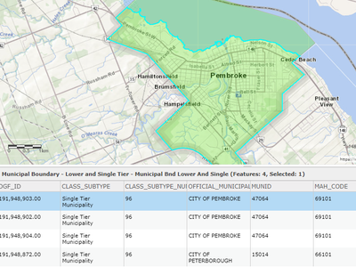

Thanks for digging, @DougBrowning . However, shouldn't my request only select one of those records from Pembroke with a geopoint? E.g., my point only falls in one of Pembroke's features (selected), in the middle of town:

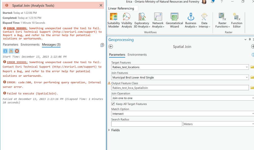

@DougBrowning curiously, a simple intersect with a test layer and this particular layer did not work in Pro.
However, the same error occurred with another similar layer from my organization that IS working with the pulldata command, so maybe a red herring.
