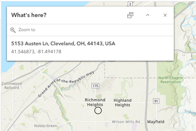

I'm getting the wrong city from pulldata statement.
text municipality Municipality pulldata("@geopoint",${stop_location},"reversegeocode.address.City")
The surveyor is out and submitting the surveys OK. Reviewing the data, it returned Cleveland when it should have returned Richmond Heights. Looking at other surveys, it seems to default to Cleveland, rather than surrounding suburbs. We deleted and downloaded the app on an Android tablet, same results. We tried IOS phones same results. The latlongs are correct.
I load the app into Connect, drag the cursor to 41.55314402824791, 41.55314402824791 , hit the check and it returns Cleveland, rather than Richmond Heights.
Other than city, the survey has been working fine. Attached is a copy of the xlxs.
Any help is appreciated! Thanks!
Neal_t_k
The issue doesn't seem to be with your form or calculation,  The locator the default geocoder is using seems to use Cleveland as the city for many of the surrounding areas.  Guessing something to do with the postal system?  You might try a different geocoder if that option is available to you.
