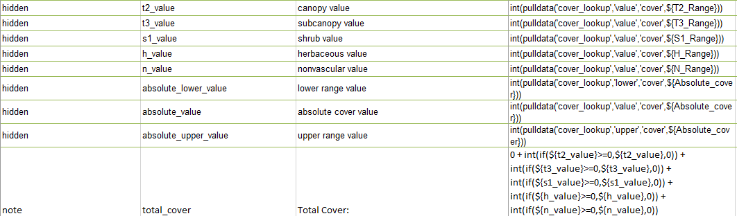

I have loaded external data into the media folder in my Survey123 folder.
GRSM_species_list is the exact name of the csv in the media folder.
cover_lookup is another csv in the media folder.
I am not sure how to interpret the error message I am receiving. #
When I publish the form I get the following error message:
Error: Initialing Form...
  • External instance "GRSM_species_list" is empty.
  • FormLogicError: instance "cover_lookup" does not exist in model

The form has a couple of issues:
1) You are using + instead of the concat() function. The webform does not support the use of + to create a string
2) The .csv has a column title with spaces in it - try updating it to be: GRSM_Scientific_Name_GRSM_Code_USDA_Code_USDA_Common_Name
Fix those two things and the form will run.
Thanks
John

The thing that is causing this issue is the following:
int(pulldata('cover_lookup','value','cover',${T2_Range})) - note that there are a few examples of this in your survey.
This returns an integer, but you are using it to update a text question.
You should remove the int() statement - or use a integer or decimal question instead.
Please let me know if you need any further assistance with this.
Thanks
John

Thanks for sending the updated form, very helpful. One remaining issue is that concat won't work in this instance. We don't want a concatenated string of values, we want to sum of several integers.
If we use concat we end up with, something like 30 + 40 = 03004000
This zipped version works in that is provides the sum of the values we are looking for. I experience no error in Survey123 Connect when testing, but when I publish, I get the same error: FormLogicError cover_lookup does not exist in your model.
Perhaps this means it will work in the iPad app, just not in the web app?
