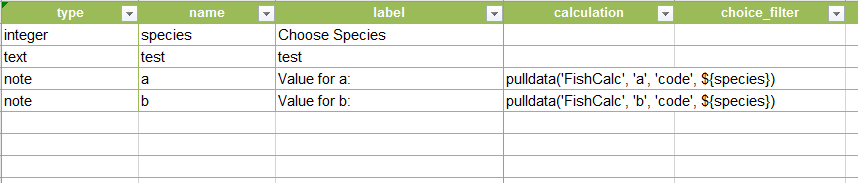

Working with Survey Connect we are using the PullData function
Formulas—Survey123 for ArcGIS | ArcGIS

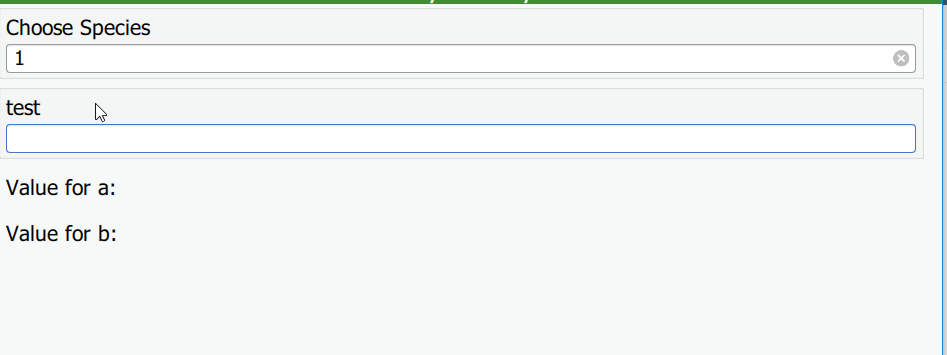

I came across a case where they had integer as the type

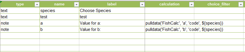

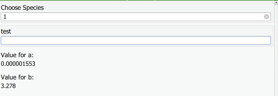

It failed in the App
When we changed it to text it worked

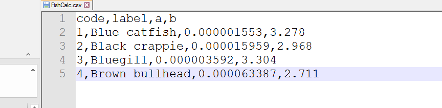

Here is my csv
Essentially it looks like to make PullData work the type needs to be set to text - irrespective of what is in the CSV file.
Is this a known issue?
Thanks
John

Hi John,
Survey123 initially reads all of the values of a CSV file as text, so the comparison operation must use a text representation.  If there are only a few questions using pulldata, it's probably easiest to use the string() function to convert the type of data inside the pulldata function - pulldata('FishCalc', 'a', string('code'), ${species}).
