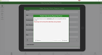

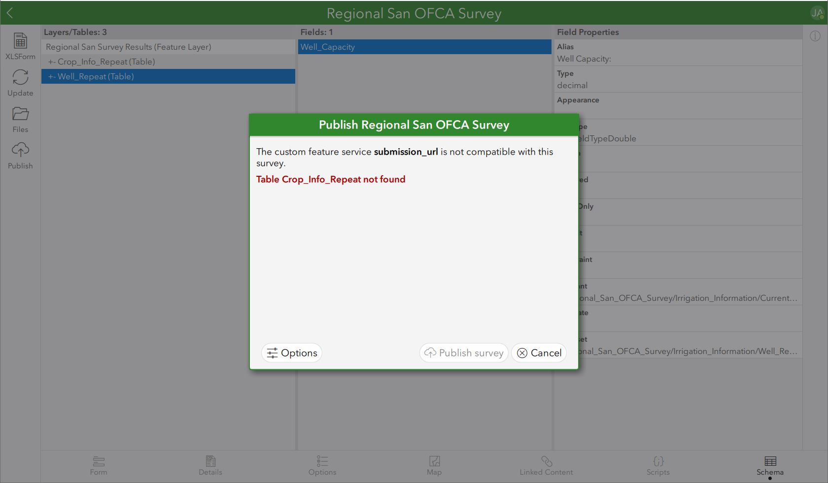

Now, when I go to publish the survey, I get the following error:
Does the hosted feature layer need to already have tables for the repeats added to it prior to creating the survey? Can anyone help with this?

You need to match the Name column on the begin repeat line to your repeat table name.  That is how it finds it.

Yes, either have the existing feature service match the data model (i.e. have a point layer and table with all fields configured) or create a new feature service from scratch from Connect upon publishing. For the latter to work remove the submission url/item from the settings tab in the XLS if you copy from your old XLS, this references the existing item to update.

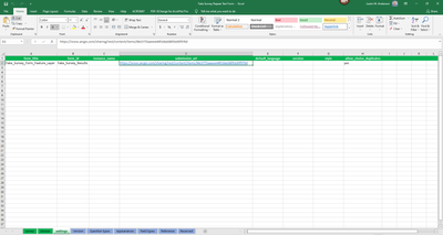

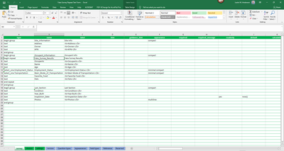

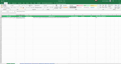

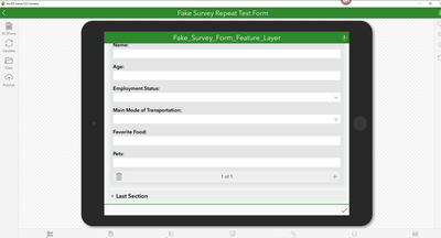

@DougBrowning  - Thanks for responding! For this example, I created a new, fake survey as I didn't want to risk unintentionally editing an existing survey. I attached screenshots of the form, XLS form, feature service, the error that I'm getting, and the settings page of the XLS form. Please let me know if you spot something that I'm missing. Thanks again!

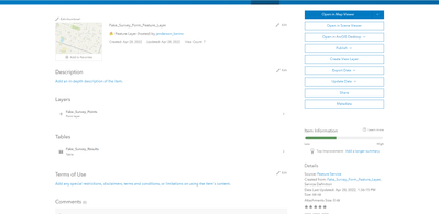

Can you screen shot the service page though also.  Link in the bottom right.

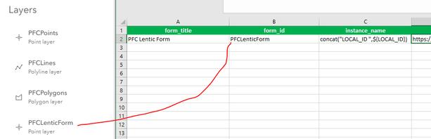

I think it may be that form_id should match the main layer name Fake_Survey_Points and then the repeat name matches the table.  You got the repeat table name in both spots.  Try that quick.  If not post the rest page.

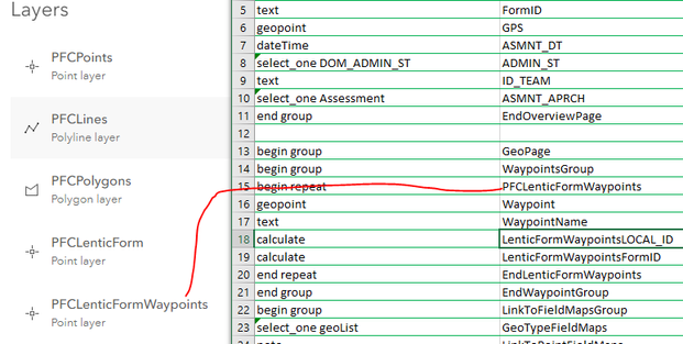

Hope that helps you are just matching up the names in the two places.  That is how 123 finds them.

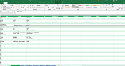

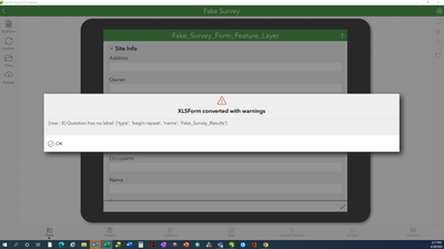

So, I redid the survey and changed it so that the form ID matches the main layer (point layer) and the name of the repeat matches the related table and now I'm getting this error:
The error says that I don't have a label when I clearly do. What am I missing?
