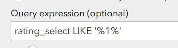

Have you tried %?
Will find "1" from a list:
More details here.

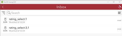

it worked, I had the quotes in the wrong place, inside the percentage signs
