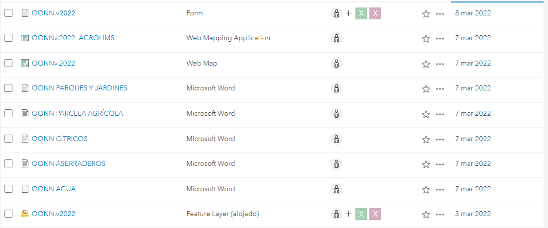

When I publish it everything goes fine until the end that does not complete, also when I go to the arcgis web page, the form file has been uploaded without problem, but the layer (feature layer) appears to me that it has not been uploaded correctly although the updated data appears to me.
I attach an image to make the problem clearer:
it can be seen that the form is dated March 8 while the layer is dated March 3.

If you can see new data been added to the feature layer, then your survey was published correctly.
I believe the modified date on the feature layer is the date you created/uploaded the feature layer to portal or AGOL or updated the schema of the feature layer NOT when the data is written to the feature layer.
In the example below you can see that the feature layer modified date is different from the form modified date. This is a survey we currently have in production, I created a web map and web app to show the progress of the data collection efforts and we haven't had any issues.

gracias por contestar, en mi caso cada vez que publico una capa se me actualizan tanto la capa como el form, cuando esto no ocurre suelo tener problemas con los archivos y datos que se pierden.
adjunto foto para que se mas claro, la encuesta se creo en diciembre y se han realizado numerosas actualizaciones con sus propias publicaciones y los archivos form y feature layer siempre me han ido en concordancia.
descubrí cual es el error y es que esa encuesta contiene mas 700 fotos en la carpeta media y a partir de las 500 no se porque no se publica correctamente.
