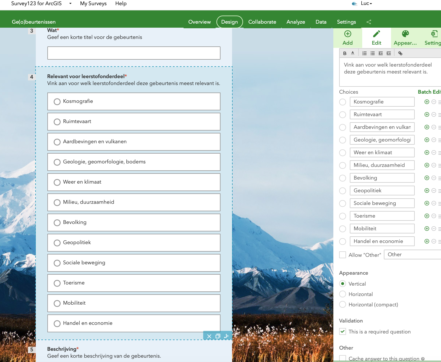

I made a survey whereby one of the questions is 'Relevant voor leerstofonderdeel' (relevant for subject).
Therefore I choose inside Survey123 for a Single choice question (as only 1 answer allowed).
See screenshot how it looked like in developing on the web.
screenshot of developing the question on the web.
When answering the question - as well in the app as on the computer the choices I made are maintained - I can see them and choose the one I want.

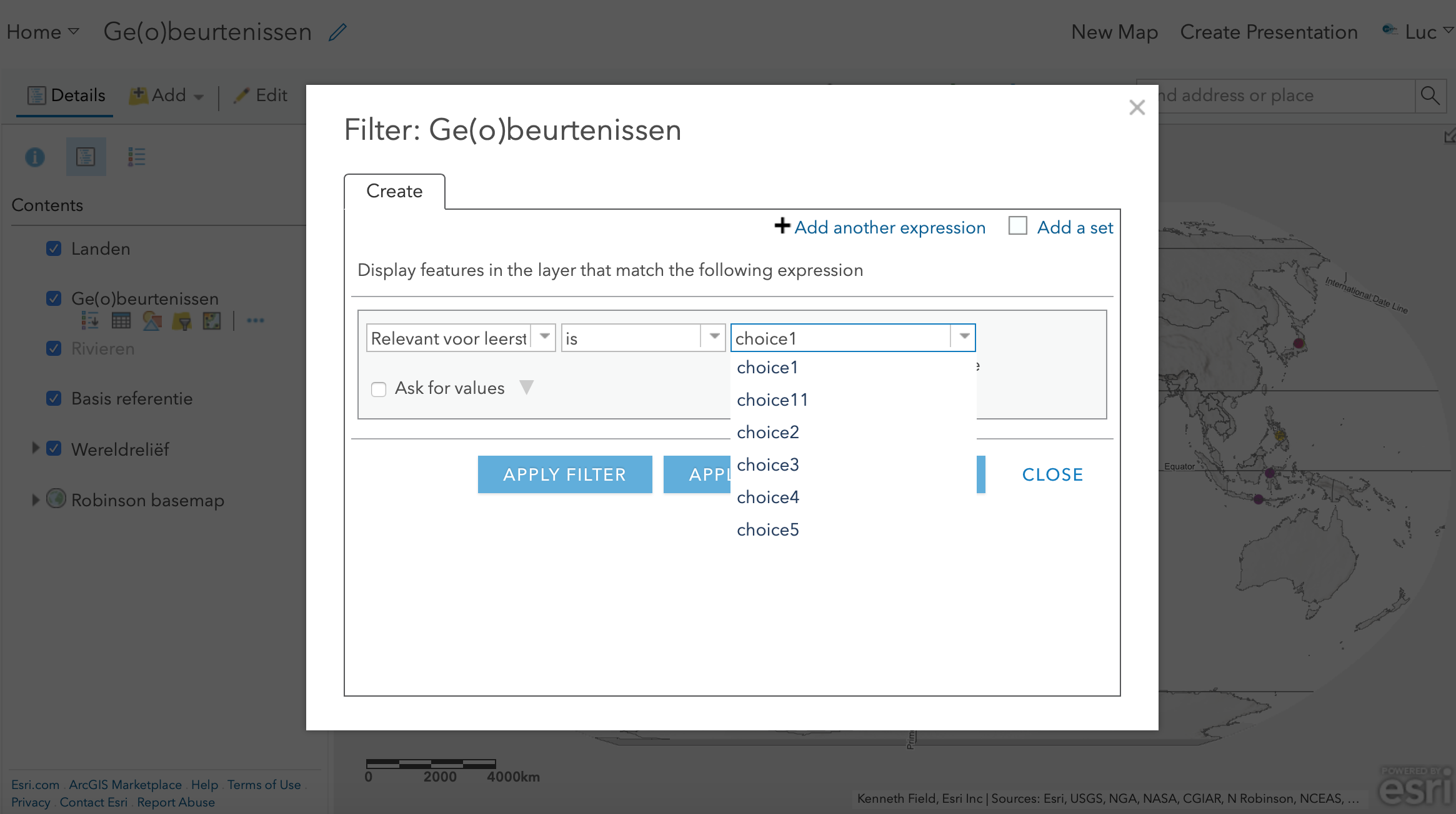

I choose for visualisation of the points that are added via the survey having each their own colour - and also in the legend it is visible, but when I click in the map on a point instead of the name of the choice I see 'Choice 2' - see screenshot or try for yourself on the map: https://arcg.is/1iae05.
inside ArcGIS online when clicking on a dot it doesn
Also when I want to filter on 'relevant voor leerstofonderdeel' it shows only a list with 'choice 1' up to 'choice 11' instead of the names I entered (like 'bevolking', 'geopolitiek') - see screenshot.
Also when filtering the same problem occurs

Hi Luc,
