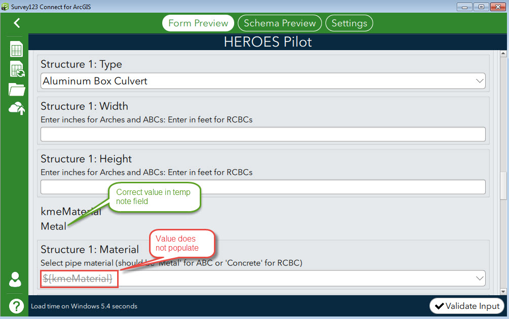

Initially I tried putting that expression into the 'Calculation'.  It does not give an error, but most of the questions in the Structure 1 group (i.e. Q1 and Q2 are no longer on the form).  If I put the expression in the default field, instead of showing the answer in Q2, it shows a greyed out copy of my expression with a line through it (suggestion expression is invalid).
I even tried adding a separate note field named "kmeMaterial" and putting the calculation there first and then referencing it in the default field of Q2.  Interestingly, the value populates correctly in "kmeMaterial" but it gives the same greyed out expression with line in Q2 (where I want to actually store the permanent answer).
Attached is a screenshot that shows how the last trial looks in Survey123 Connect.  As you can see, "kmeMaterial" correctly shows an answer of 'Metal', however, the "Structure 1: Material" (i.e. Q2) has the issue.

Default values are populated when you first open the survey, for this reason default values can not contain calculations that reply on an answer to a previous question, as at the time of opening the survey these previous questions will not have been populated. Default values are best used as static values that you want populated the same every time you open the survey.
The correct way would be to put the calculations in the Calculation field and use the IF statements you highlight above against those questions you want to populate based on previous questions. Calculations are evaluated and populated every time an answer changes int he survey.

Currently Survey123 does not support calculations on select_one question types, there is currently a feature enhancement in the backlog for this request. Therefore this is reason when you add a calculation to the Structure1_Material question you will notice the questions in that group do not appear in the survey. An alternative way to do this would be to use choice_filter function and assign the select_one choices with the structure type in the choices tab. The user will still need to select the answer from the dropdown, however they will be provided with a smaller list of options.
