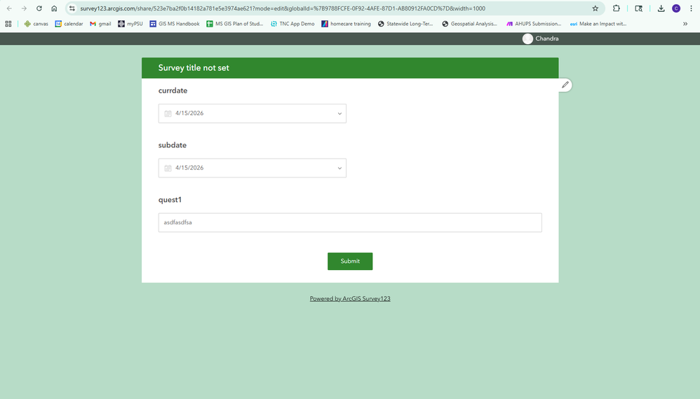

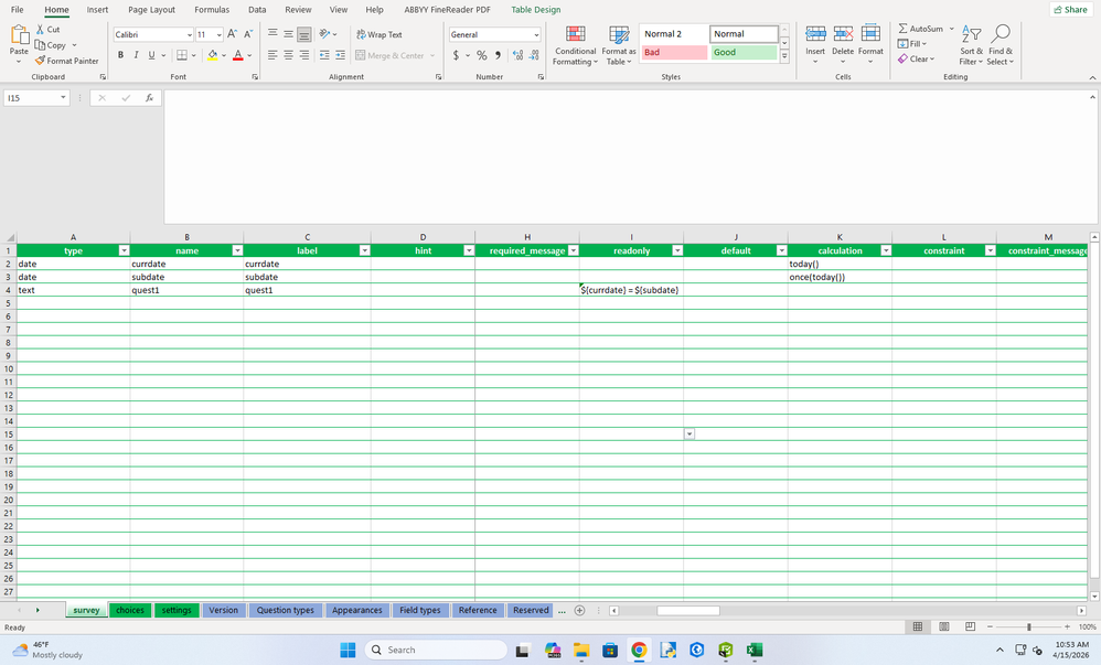

ChandraLala
Thank you for your help. I tried this but it is not working for me, I'm not sure why I am still able to edit answers with the editing link. I included the calculationMode as well for the current date row, it just isn't shown in my screenshot.
My understanding is that since I set the conditional read only statement to evaluate to TRUE when the current and submission dates match, I shouldn't be able to edit my answer in the scenario above.
