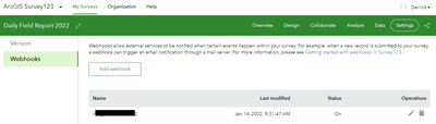

DerrickWestoby
Have you verified that the webhook ID in the Survey123 website is (still) the same as the one you're using in Power Automate?
I've had situations where I update the form in connect and end up breaking the webhook.  When using the field app, you need to re-download the survey to pull in the new webhook.  (I assume this isn't an issue for you when using the web form) I've also had a few occasions where I needed to recreate the link to integromat because the web hook that was shown on the S123 website wasn't matching what I saw in integromat.
