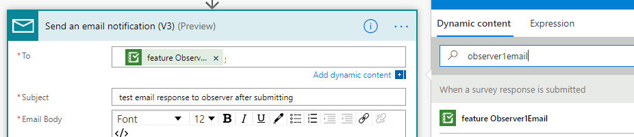

2. When posting a message to an email, is it possible for the "EmailTo" to be sent to an email address specified in a field in the survey form? It seems like I can drop this field in here, so it should in theory be succesful but our org does not yet have the email exchange set up, so I can't confirm. (see pic below).

2. Yes, if the destination e-mail was entered in the form, it can be used in the 'To:' field during e-mail composition.

I'm glad the email field will work when we get exchange online enabled.
