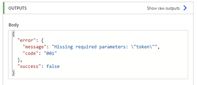

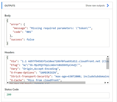

I've absolutely loved using the Create Report action that has been added to Power Automate, however I have run into this issue twice now where my flows start failing and I see the error message:
Has anyone else been experiencing this issue? I know the ArcGIS Connector itself had a 14 day timeout on the token for a while, but never saw this with Survey123. As soon as I go to my connections and sign back into the Survey123 connection my flow works fine again.
Is this a known limitation or am I doing something wrong?
