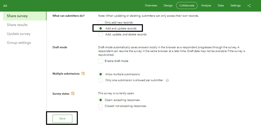

I am guessing that the permissions in the survey layer are set to avoid other users from editing the data.  Since you are the owner of the survey, you can edit, but others may not have edit permissions.
In the Collaborate tab, make sure you have the 'Add and an update records' option on. Also make sure you hit Save.
If the above is all set correctly, and it still does not work, please provide some details about what you mean by 'it does not work'.

Thank you for your prompt reply. I've followed the steps in your reply and I can now link the List in the dashboard to the embedded survey123 form and when I click on a list item the right survey shows in the form. But if I'm logged out of my ArcGIS Online account (to replicate another back office user) when I try and edit the form and press submit I get the following error message:
Failed to submit. - No permission to edit the specified feature.
Our set up here is perhaps the problem. We have a limited number of users with full AGOL accounts and then the rest of the staff have access to our own Enterprise portal which isn't public. Therefore to create a public survey I have to create it it AGOL, make it available publicly, then import the results feature layer into the portal and embed my credentials. i then use that layer in the portal to build the dashboards etc that staff will use in the back office to see the survey data, and hopefully be able to edit it.
