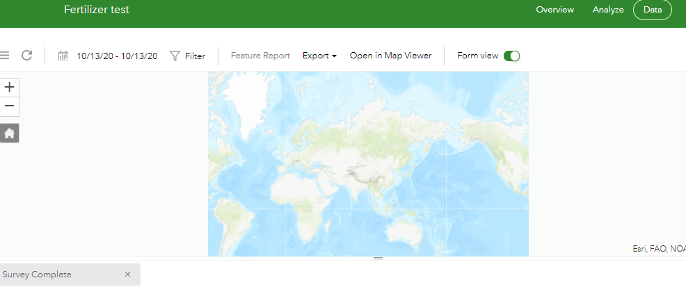

Issue:  When viewing the Share Results viewer(Overview,Analyze,Data) for Survey123.com as the owner, surveys entered show on the dashboard but only the repeat table show on the Data tab, and thereby, no points on the map.

So when I view the Data tab in the full Survey123 site for the survey, both table tabs show up under the map: the main table (Fertilizer test) and the repeat table (Survey Complete).
When I launch the Share Results dashboard from the Collaborate page, only the "Survey Complete" tab shows the the dashboard shows the correct number of surveys submitted.

Sorry for the late response, we were busy wrapping up the new release. There are a few possible reasons for the behavior:
1. The layer has the visible range set to a specific scale range. Could you please select a point and then try zoom-in and zoom-out to check if the point appears on a different scale?
2. The layer's point symbol is not clear enough
3. The layer does not have a geometry field
If the above is not your case, please click the open in map viewer button and let me know if the point can correctly appear in the map viewer. Another question is whether this happened to all your surveys or just specific one? Does this issue just occur recently?
