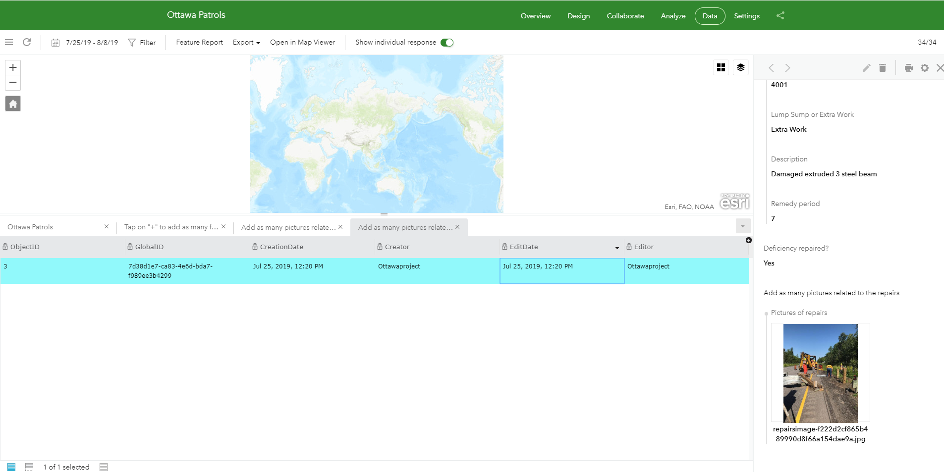

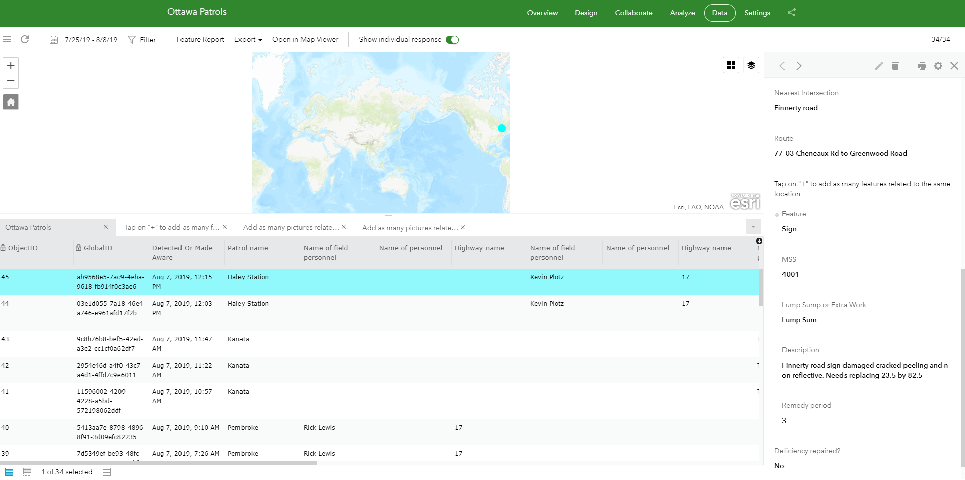

Have an issue with a survey that doesn't show the pictures, the thing that 1 week ago it was showing it until I got a called that the pictures wasn't showing in the uploaded surveys. I don't have as many records because this survey is in a "Pilot" phase but still need the pictures to be there.
From those 34 records on "Ottawa patrols", every one of them had pictures but now are not showing (see screenshot above). Only in one of the "repeat" questions that is on the last tab is showing the pictures (see screenshot below).
Just created a new survey and the field guys are using that one, wonder if there is a way to "restore" the photos from the "Ottawa Patrols" survey.

Could you check the feature service via the Item Details page's Data tab and see if the attachments are present?  Was the image question capturing the photos renamed during the form creation process?

There are no attachments in the feature service.
The weird thing is that only is showing on the repeat repaired.:
The image question wasn't renamed. It is a "repeat question" that shows like this:

This looks correct based on the form design - because the photo is in a repeat section, they will be in attached to a record related to the primary record.
