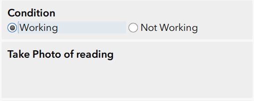

The survey opens with no selection on this question
before selection
Choosing Working opens the question for taking a photo. There is no icon
after selection
If I uncheck Working and check it again the icon shows.
not working helps expose icon
I have a second photo question that is not based on an conditional logic. It should just appear on the form but it doesn't.
