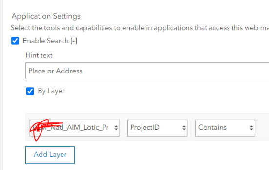

The way I have done it is to use find and give it a value of a field that is part of the search in the web map settings.  Not sure there is a query parameter for maps.
Find the location of a feature to open the map
Use &find= followed by any search string.
https://www.arcgis.com/apps/mapviewer/index.html?webmap=8152694dd9594393a1db4d62d2020fe3&find=Niagar... Falls
See here  https://www.esri.com/arcgis-blog/products/arcgis-online/mapping/use-url-parameters-in-map-viewer/
