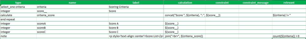

This is my XLSForm configuration:
The XLSformThe XLSform

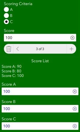

This is the expected result:
Expected ResultsExpected Results

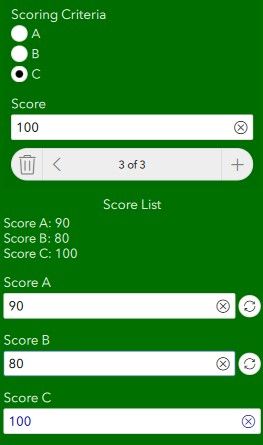

This is the given result:
Given ResultsGiven Results

I'm not sure if you need a repeat here if you have a set of questions and a set amount of repeats. But anyway.
What you can do is use the below to refer to a question within a specific repeat:
indexed-repeat(question, repeat, index number)
You should also consider the repeat_count to limit the number of repeats (e.g. 3 for A, B and C).
You can also consider calculation modes in the bind parameters, if the calculations are not re-triggering.
