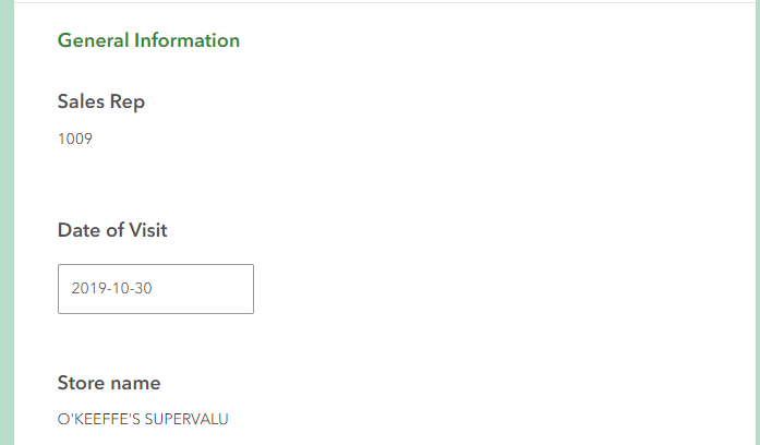

Accessed from Web Map:

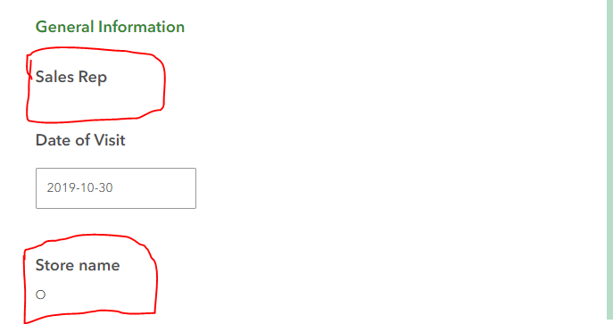

Accessed from collector app for windows. See the Sales Rep is blank and Store Name is partially filled in.

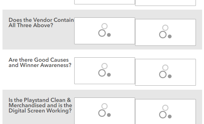

Table view in web browser:

we have most of the issues sorted but the outstanding one is that the table view in the browser it is still the weird select questions as seen above.
Thanks
Yazy
JodyZhengLiu
Hi Yasotharan,
The table-list appearance set on the xlsx form is currently only supported for select_one questions in the web app, and not supported for select_multiple questions. We have an internal develop issue for this but if you could kindly log an enhancement ticket for this through Esri Support would help us assess demand for the enhancement and prioritize it accordingly.
