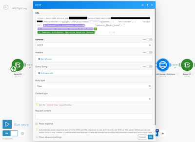

You can do this with integromat.  I have a scenario for "UAS Flight Logs" that updates a pilot's cumulative total flight hours on submission.

Honestly, it took a ton of trial and error for me to get this working and it was my first and only experience with trying to push updates back to a feature layer like this.
I used "Postman" to test the URL string that I was using (also, a lot of trial and error).  I'd definitely recommend you install that and use it to test out your request before bringing it into Integromat.  I couldn't get it to work when I was adding to the query string, so I just used the entire URL (including the query parameters) in the "URL" entry box on Integromat.
