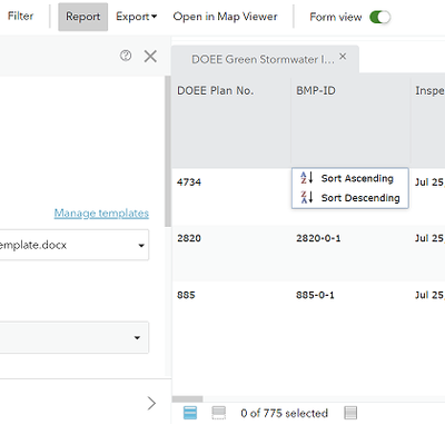

You did "Sort Ascending" within the Survey123 interface? If you do it here, it should work...
And no, you don't *have* to create a sort field, you'd only need to do that if the rows weren't ordering the way you wanted them to when you selected Sort Ascending or Descending.
