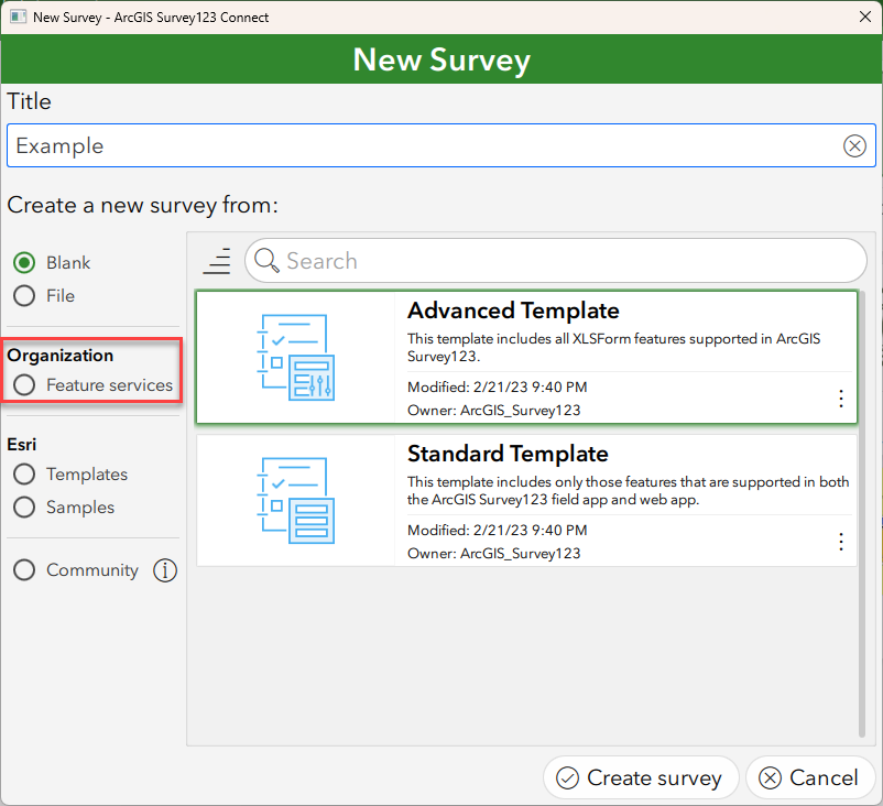

In the past, there was an option within Survey123 Connect to create a new survey based on other existing published surveys within your organization. It was different from the option to create from a Feature Service, in that it pulled the exact XLS form and configuration from that survey, instead of just creating a generic template of questions based on the data field types. This was incredibly helpful for IT/admins for troubleshooting purposes, because it allowed you to create a copy of other users' surveys and test solutions or workarounds without editing the originals.
I recently upgraded Survey123 Connect to v3.17.55 and see that this option is no longer there (can't remember what version I was on before, now). Under Organization, it now only has the 'Feature services' option.
Is this intentional? Are there any plans to bring this option back? Perhaps user error? I see the workaround could be to use the 'File' option and upload a copy of their xlsx, but the extra steps of guiding the user to locate and send over that file is a pretty inconvenient back step in functionality when the option was there in the past. Below is an image of the current options in 3.17.55.

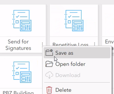

jcarlson
MVP Esteemed Contributor
Go to your list of surveys, find the survey you want to copy, then just do "save as..." to create an exact copy of it.
If you need to submit data to the copy and want to keep things separate from the original layer, just open up the settings tab of the XLS file and remove the submission URL. When you go to publish the copy, it will create a new layer.

AlisonOBrien
Hi @AaronKoelker ,
I have Survey123 Connect version 3.18 and there is the option to create a new survey from existing surveys in your organization.
Let me know if you are able to see the same thing by updating to version of Survey123 Connect 3.18.
Alison O.
Esri Canada
AaronKoelker
Hello @AlisonOBrien,
I went to download the latest from the Survey123 website, which appears to be 3.19. I'm still not seeing the option though, unless it was added back for 3.18 and removed again in 3.19, which would be weird. My New Survey window still looks the same as the screenshot in my original post, above.
-Aaron
