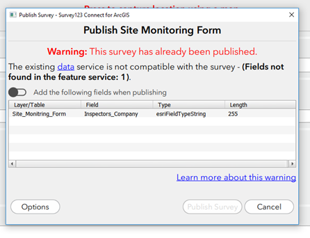

Works fine locally.  But as soon as I go to up load the form and publish it, I am now hit with a warning that I have never received before when simply adding a question.
I know what happens if I ignore this warning.  And it seems silly to get it when we are just adding a new line to the survey.  Again, in the past we never had this issue.

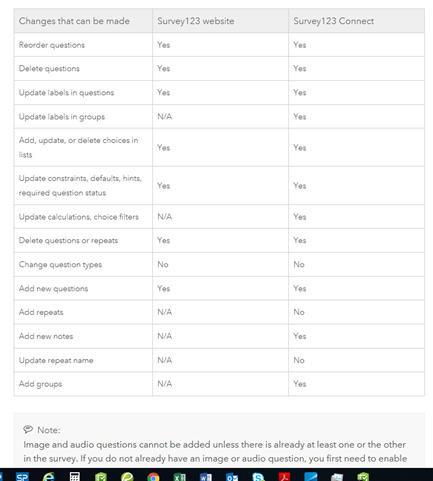

I checked to make sure that something hadn't changed and according to the list provided by ESRI, I should be able to add questions without blowing up the current survey.

Hi Jeff,
What you are seeing is intended - It is asking you to confirm that the fields will be added to hosted feature service.  This does not republish the table, just add the fields to it.
JeffJackson4
Ok.  Thank you.  Is this a new feature?  It's never popped up before now.
JamesTedrick
Esri Esteemed Contributor
Hi Jeff,
This was added in version 2.5 (late 2017).
