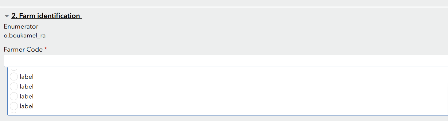

I am trying to upload a list from my csv file uploaded in my media folder.
This has worked before, but the app doesn't seem able to read the csv file properly.
Here is what i get on survey123 :
And the number of times label appears seem to match with the number of lines.
This doesn't work either with pulldata().

This is often a special char or some other formatting issue with the CSV.  Look for that.  Often using notepad vs excel lets you see them better.  If you do not see it then post the csv and the calling line from the form.

Thanks a lot for your response ! Indeed, my csv were separated by ; instead of , .  It sort of work now.
Now i have another issue : this question is supposed to select villages, but i am not getting the list of villages with duplicates. How can i remove duplicates from the list ? Many thanks again for your help
