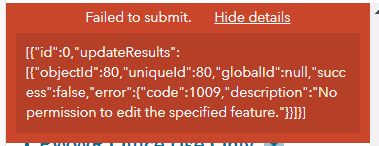

Hello.  We have had great success embedding Survey123 forms (built using Connect) in our Dashboards.  This allows us to add new survey records and edit submitted ones directly in the embedded survey, and see the results in the dashboard web map and associated elements.  Following this model, we built a dashboard to review and validate lead service line survey submissions as part of our service line inventory.  We began noticing the error in the screenshot below.  This error occurs when we attempt to edit an existing survey record in the dashboard as the first thing we do.  If we then open the Survey123 web app, refresh the dashboard browser window, we can then submit the record successfully in the dashboard environment.  Completing the survey form in a separate browser window successfully submits the survey record.  Hosting is on ArcGIS Online, and we have re-checked the various editing permission settings.  While we have a work around, we would like to resolve this issue and understand its cause.  Many thanks in advance. Regards, Jay

Usually updating the existing features requires supplying the globalId, but it's null in your screenshot.
Try including &globalId={gloablid} in the URL?

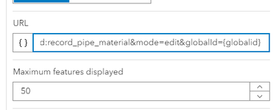

Yes, we see the null comment in the error.  The tail end of our URL has:
I thought changing the letter case in the {globalid} to {globalId}, but this did not work.  Puzzling.

Can you copy the text from the URL and put it into the embed's description, in order to visually confirm the URL that it's navigating to? It ought to be sending the globalid, but would like to confirm.

Hi Josh,  Thanks for the great troubleshooting tip.  Added the URL to the embed's Description.  Selecting different records shows the unique globalids.  Puzzling.
