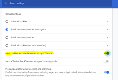

Also try to update the Chome browser, clean the all saved password for arcgis.com, enable clear cookie setting , and close all sessions and restart the chrome browser. Sometime a full cleaning might be required to clear all associated cache data and cookie.
