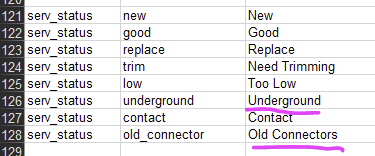

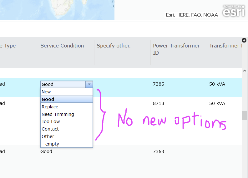

After adding new options to several questions in Survey123 Connect, to an already published survey, and republishing the survey, the new options don't show in the Data Table field column in survey123 website.

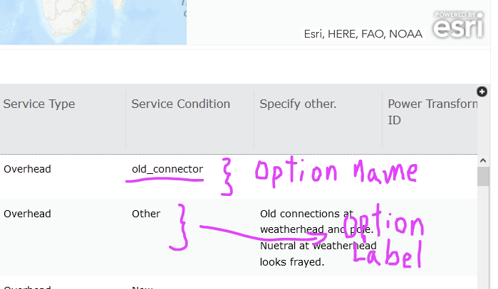

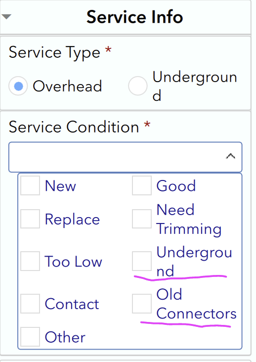

Also, I noticed that when new surveys are submitted using the mobile app where the answers include the  new options, mentioned above, the Data Table shows the "name" value instead of the "label" value of the new options.
Excel Form Options (Highlight new options)
Data Table Not Showing All the Options
Mobile App Question with New Options
Answer with New Options Shows the Option "name" Instead of the "label".

Hello Billy,
I understand that the behavior you are experiencing could be because the coded value domains in the underlying feature layer (service) has not been updated, which is what causing the discrepancy between editing in the web and mobile app.
Could you please try the following:
  1. Sign in to https://arcgis.com and go to the item details of your Survey123's feature layer
  2. Go to the Data tab > Fields
  3. Click on the Service Condition field.
  4. In the field details, see under the List of Values (domain) section. Are the two newer options presented in the list?
  5. If the options are not presented, please add them to the list by clicking on Edit and add the label and code (name) accordingly.
Please find more information on step 5 here: https://doc.arcgis.com/en/arcgis-online/manage-data/define-attribute-lists-and-ranges.htm#GUID-6E9A9...
