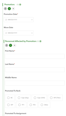

I am struggling to figure out how to get the data I am collecting through nested repeats into a format that will not send 9 emails via Power Automate every time there is a submission. I tried initialize variable (string and array), but I can't get the parent repeat to match up with the child repeat. I either get blank fields for the parent or blank fields for the child. I was thinking I could probably create a hidden field in my survey to bring all of the data together but my head started to explode. Thanks for the help!

@abureaux my mind is blown. But I started walking through it and didn't see these fields in my code, uniquerowid and parentrowid. I'm assuming it's globalid and parentglobalid? FYI - before I heard back from you my work around was to put the parent repeat values I wanted as hidden fields in the child repeat. So the users only had to do one data entry, but the data was available to me at the level I needed it without triggering 9 emails. I also attached the text if that's easier.
