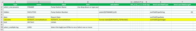

In the meantime, a temporary workaround might be to create a calculate field (with the bind::esri:fieldType set to esriFieldTypeInteger) that formats the date into a YYYYMMDD format. Then you could use the max statistic in the report to find the most recent date based on that field (see screen caps).
