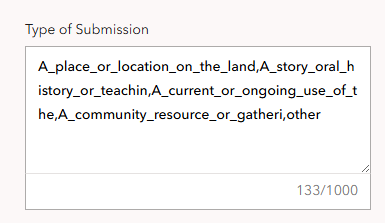

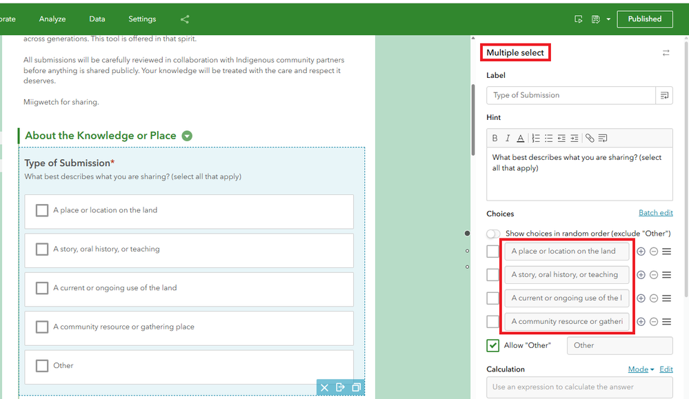

I've used the Survey123 wizard to create a survey in AGOL. The survey has a Multiple Select field. I've entered picklist text values.
Outside of Survey123, such as in Experience Builder, the picklist values are a comma-delimited list, with underscores instead of spaces.
As far I can tell, the Survey123 picklist isn't a true CV domain in the feature layer; the picklist seems to only live in the Survey123 form.

I want the picklist values in the layer to be easier to read in Experience Builder. Is there a way to edit the "coded values" by replacing the auto-generated underscores with spaces?

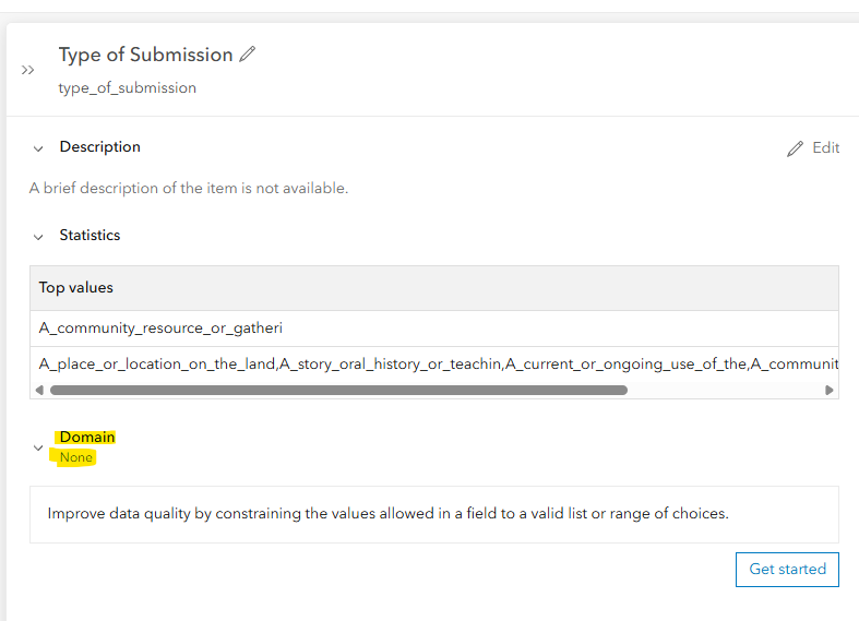

I assume this should the same for feature service created through the Survey123 assistant: In AGOL, go to the feature layer, click the data tab, then the "fields".  Select the field with the list options. You should be able to edit the domain from there.

It says the Domain = None.
ToddW_stl
I think if you click "Get Started" it might convert the choices into a domain list and allow you to update the Name labels to remove underscores.
https://doc.arcgis.com/en/arcgis-online/manage-data/define-attribute-lists-and-ranges.htm (similar to what @Neal_t_k mentions)
