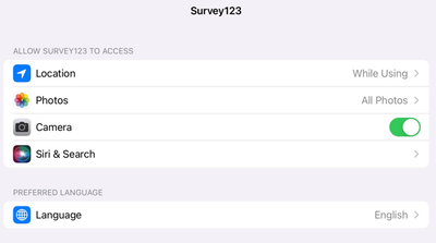

Hi @MatthewRogers,
For the issue with iOS app and camera roll when using an image question, can you confirm if the access permissions for the Survey123 app are correct and were accepted for all photos when prompted. You can also check this in the Settings app if you scroll to the bottom app list and select Survey123, as below.
Another thing to try is to uninstall the app completely, and reinstall from the App Store, this will ask the access permissions questions again, and be sure to select all photos and allow camera and location while using. It could be possible when updating app in place (over the top) there is issues with permissions to the gallery and files app.

MatthewRogers
Hi @Anonymous User,
Thanks for your suggestion with this. I appreciate your assistance.
I am still having issues with the photo loading from the camera roll. Please see my response to @JamesTedrick where I explain what is going on now. I have made sure that I have on all photos in my settings. I also tried the uninstall-reinstall solution you mentioned but that didn't work. As I mentioned in my response to James Tedrick I discovered I could get to the cameral roll in a roundabout way by swiping up out of the form but not completely exiting and then coming back to the form and the camera roll would be up and I could add a photo. It's weird and not ideal but I guess it works. I should also say that when I test it in Survey123 connect I am able to reach the files and upload a photo from my computer without a problem.
Thanks for any suggestions.
Matt

MatthewRogers
Hi @Anonymous User ,
I have embedded a screen recording of what is occurring on my end. I have also attached the a screenshot of my Survey123 settings in case you see something I am not seeing that needs to be done.
