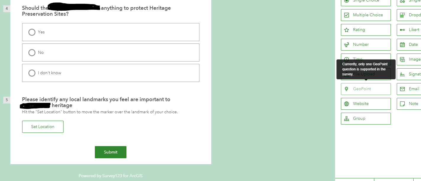

I'm working in Survey123 and it looks like I am only allowed to have one GeoPoint associated with each survey:
Does anyone know if there is a way to have multiple GeoPoints with each survey?
Or does anyone have any suggestions on a work around? Maybe using Collector App?
I'd like to ask about multiple historic sites in the community along with asking where the respondent is from.

Hi Hannah,
The limitation of one point (geometry) per table is a system limitation of ArcGIS and affects all applications.  You can create a survey with multiple points using Survey123 Connect:
- Survey123 Connect supports creating repeats, which store data in a related table; the related table can store an additional geometry.  See Repeats—Survey123 for ArcGIS | ArcGIS for more information
- You can include geopoint questions in a form that do not submit their geometry (using the keyword null in the bind::esri:fieldType column) and have additional questions store the latitude and longitude; see The Power of Nothing for additional information and a sample.
In your situation, it sounds like the repeat method would be best - you could ask a set of questions and the location for each historic property.
