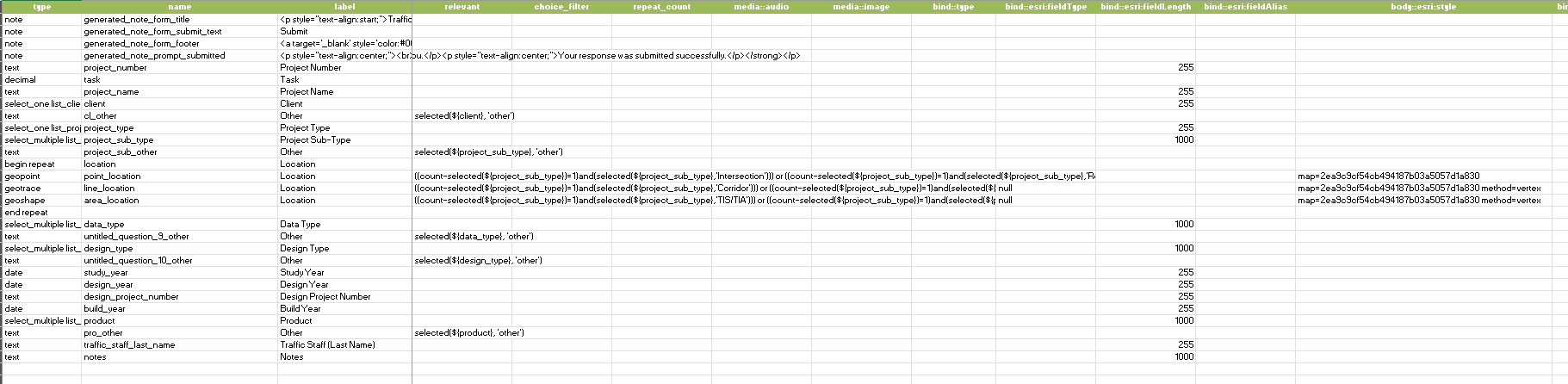

Hi, I am having an issue with the repeat feature in Survey123 Connect.  I started my survey in the web app to get the structure set up along with conditions for questions.  I have all three options for the location maps (point, line, area) and only one option is available per constraints from prior form questions to select the desired mapping functions.  The survey is capturing all location types when the forms are submitted, but only correctly locating the point style locations.  The line type and area type locations are being placed in the South African Ocean.
I want to be able to have the different location types available depending on the data being entered.
This is what I currently have for the XLSForm.

A layer can only be one geometry type period.  So there is no way to have all 3 types in one layer.  This is not a 123 limitation but a core ArcGIS limitation.
The way to pull this off is to have 3 different repeats - one for each.  Of course then your fields are in 3 different layers also.  But it is just the way it works.
