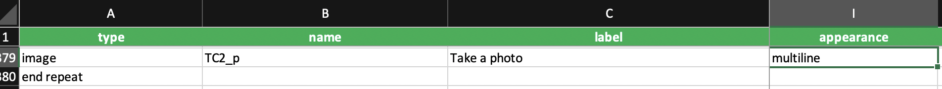

I've got a survey that utilizes the multiline images. I am now trying to create a Report that displays all of the images that were taken for that question. However, when I create the report, it only displays the first image. What is the syntax needed to display all images?
Below is what I am currently using, with a screenshot of the relevant XLSform fields. Thanks in advanced!
Syntax in Report:
Photos
${TC2_p | size:188:0:0:300}
XLSform Field:
