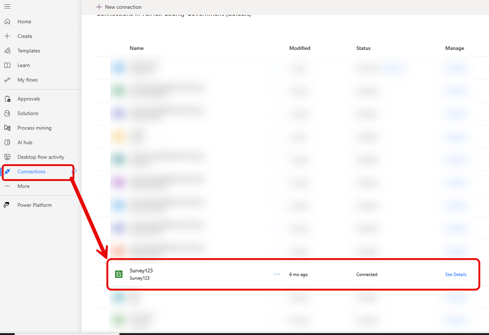

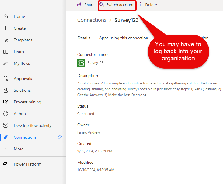

ScottBrown1
I have had similar reoccurring issues.  Try logging into Power Automate, select Data from the menu, then Connections.  Go to Survey123, click on the "..." (More Commands) and select Switch Account. Log back in under the original account.  This should reconnect your Power Automate to Survey123 and display your dynamic content again.  It's worked for me several times, hope it helps!

ScottBrown1
butterip
That worked for me too. Thanks!

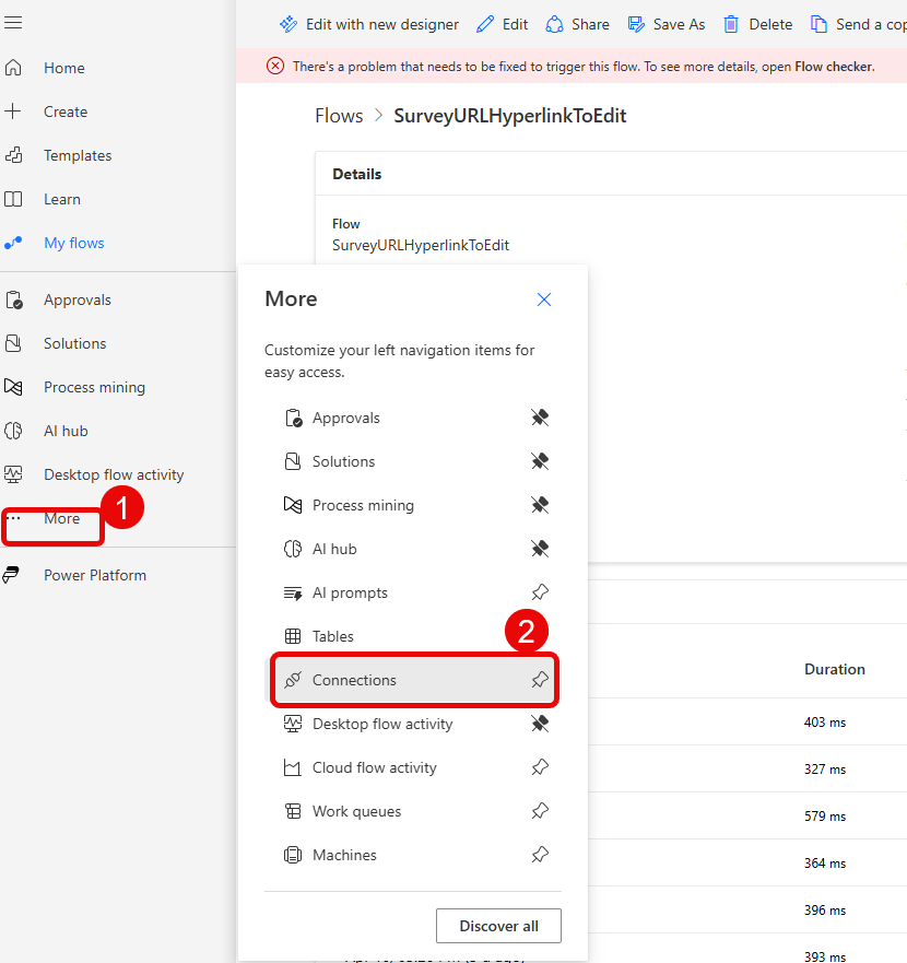

NLI_Wendy
I wonder if this is set up differently now that it is a few years later? I am having this same issue but I am not finding where you select "Data" from a "Menu".
andrewdfahey
@NLI_Wendy I hit the same issue since I don't live in the Power Automate space. Found it just a bit ago and wanted to add it here in case anyone else stumbles into a similar issue since you may have found it by now. Along with what other folks have said, once I "switched accounts" dynamic content worked again for me
