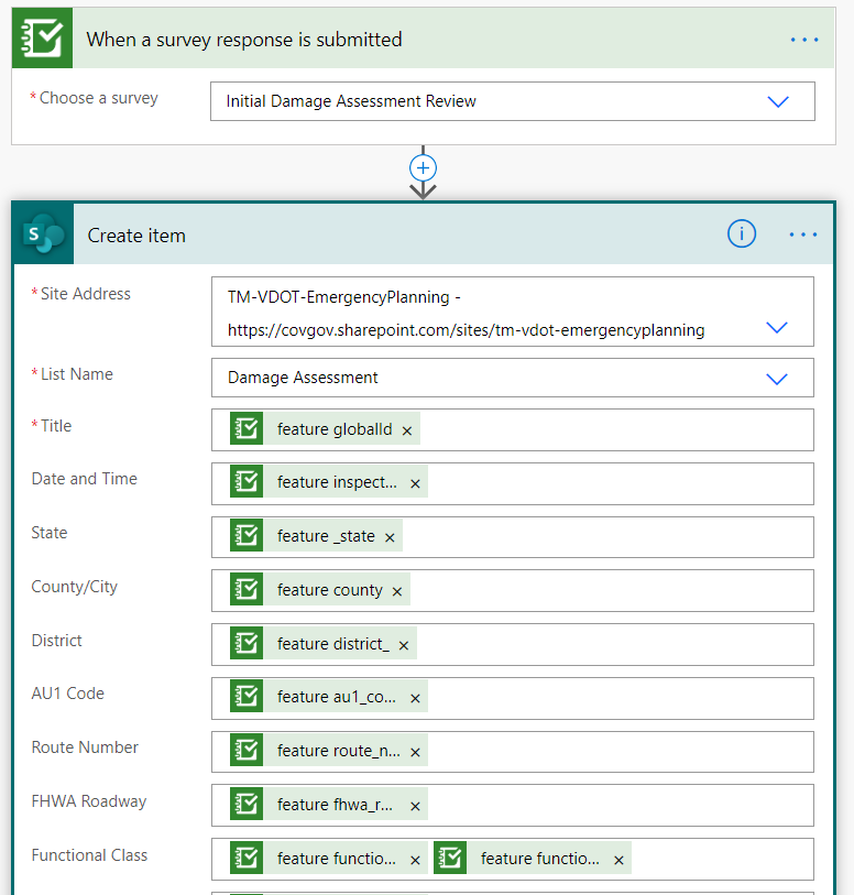

I set up an automate flow using Microsoft Power Automate.
The Flow shows up in the webhooks for the survey.
When the survey is submitted the flow is not being triggered. The flow is supposed to create an item in a list in Sharepoint as see above. Any ideas as to why the flow would not be triggered?
