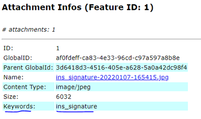

ZacharySutherby
Hello @CBarrett
Attachments are associated with image questions through attachment keywords.
The keyword is going to be the name of the image question in your XLSForm. We do have a Python notebook that assists with updating keywords on attachments.
Even though the notebook mentions that it's for ArcGIS Enterprise the workflow will also work with ArcGIS Online as well.
