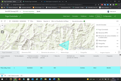

 Good afternoon, I would like to know if it is possible, and how to put more than one layer in survey123 online When publishing it creates a layer, but I would like to see if in addition to this layer I can place, modify thanks

Using Survey132 Connect, you can create a survey against a single layer from a multi-layer service. But there's no way to do this in the online form builder. And there's no way to edit more than one layer in a single form, except in the case of related tables.

its 1 layer but i need more

If you create your survey using an XLS Form, you can create repeats inside your survey.  Each set of repeats will be saved in a separate layer or table.  If your repeat collects a geopoint or geoshape, it will create a layer for the repeat.  If your repeat just collects attributes, it will create a table.  What @jcarlson was trying to say is that those repeats will be related back to the Parent main layer.  The repeats are Children to the Parent, in a 1:M relationship.  When you publish your survey, it will create one main feature service with multiple feature layers and tables within.
Example, we are working a project where there is a large area surveyed (the Parent) and multiple small areas within (the Children).  We capture a geoshape at the parent level, and then there is a repeat that stores another geoshape.
