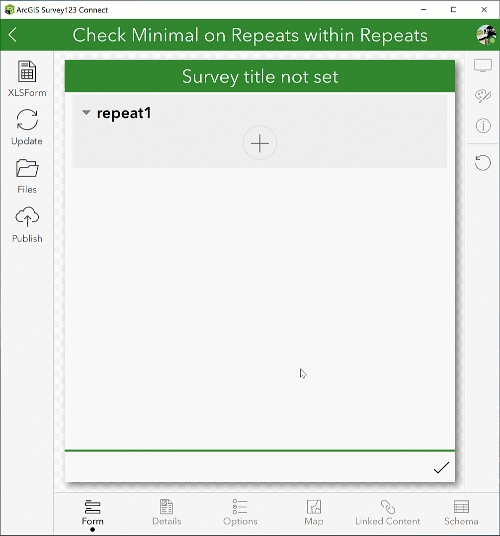

I just noticed that minimal appearance doesn't work if you have 3 or more nested repeats. It works for the first 2 repeats. But, doesn't work for the remaining.
As a result, it publishes a feature even if that repeat doesn't have any data.
Has anyone else experienced this.
Any workarounds would be greatly appreciated 🙂
Attached below is a GIF of the issue and the associated XLX file.
Cheers - Gee

Yes this is a known bug.  I posted and Ismael responded but I tried and I cannot find the post.
