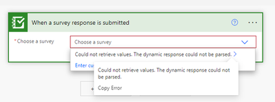

Trying to use Power Automate to create an email notification when a survey response is submitted. I am unable to select a survey from the “Choose a Survey” drop-down. Any tips for when you get “Could not retrieve values. The dynamic response could not be parsed.”? Any guidance for what a custom value is in this case?

Actually, I just found a similar support article:
Problem: The drop-down list does not display surveys in the ArcGIS Survey123 trigger in Microsoft Po...
I went back to my connections and selected "Switch Account" and signed back in.  Everything seems to work now!  Hope this helps!

Was this ever resolved?  Been using Power Automate with Survey123 triggers for some time and am suddenly having this issue.
HeatherBuchanan

Honestly I dropped the issue back then. Trying again today, no change. I can't follow the support article you provided because my agency blocks third-party cookies by default, and I don't feel like arguing with I.T. again. 🙂  Another GIS person in my agency is/will be setting up some Power Automate flows soon; I'll forward the article to him. Thanks!

OK, the solution you provided via the support article works for me if I use Microsoft Edge. I was using Chrome before.
